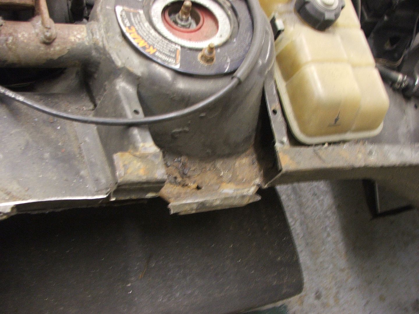

Where does your camber kit?  :?:
K-Mac - Australia
sixenligne a écrit : lun. 16 févr., 2015 00:39But you add the weight!!  :mdr:
Unfortunately yes - but not that much more than std and much less chance of corrosion trapped between the skins
The cage is 75 kgs so a little more here and there won't hurt - would prefer if it was weight added to rear of car rather than front as it would help with balance.

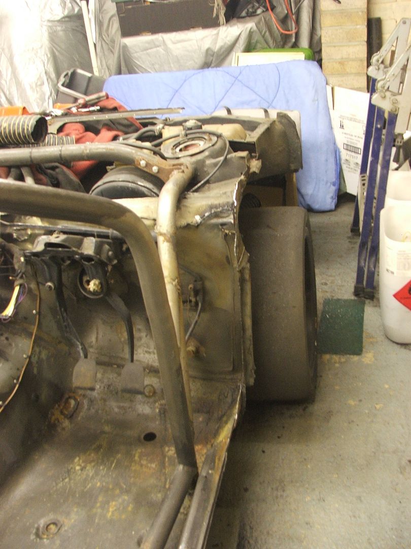

Turret top is just as scabby but I haven't hit it with a chisel yet
I did however find time to clean up the rear inner wheel arch before I tore another hole in my overalls
Finished a bit earlier than my usual 1am due to running out of "noisy hours" and having very little quiet work left for after the witching hour (10pm)
So I swept the floor under the car and all around and then had a little tidy up (yes that's my tidy - you should see my sh!t tip)
just for amusement and it means absolutely nothing in the grand scheme of things but I weighed the floor sweepings approx 70% rust from various areas of body cavities never having seen daylight for some time, 20% plasma cutter dust and 10% stones from the kitty litter from Croix that I rolled the Monza into when I ran out of talent (if I ever had any to start with) that have finally been made free (I had a daft plan to save them up to return them next time I go but you guys have changed the venue so I binned them)
I kid you not on the stones front I had rattles on track that I knew were stones and every so often some fell out (last two events with the car RRG2013 and a Snetterton track day several stones escaped but still more were rattling round!!!)
